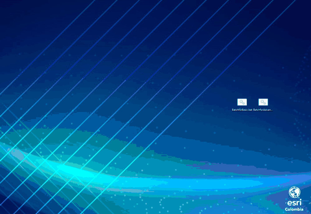

  • In the following clip you will be able to see how the Batch Files work.
    • First the Batch File for ArcGIS Pro Basic licenses is executed and as you can see, the license type is set up to Basic.
    • After that, we close ArcGIS Pro and execute the Batch File for ArcGIS Pro Advanced. The license type changes successfully to Advanced.
