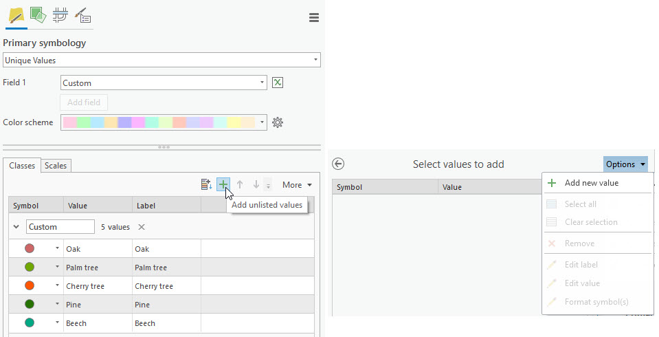

As you see below, those classes do not show in the Classes tab and the 'Add unlisted value' option doesn't list those symbols either.

AleydisG__Pere
Clicked that option and it turned grayed out.
