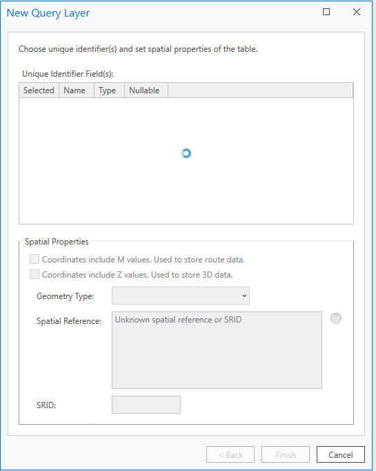

AGP 3.0 has no problem reading the content of an sqlite file in, however, adding data from an sqlite file to map hangs at a 'New Query Layer' dialog, where it seems AGP is trying to read the column properties, and fails.
QGIS does not have any problem reading and visualizing the data. Hence, I don not think there is anything wrong with the sqlite file.

I did not try the ‘Add Data’ button, but used drag and drop instead - from the catalog pane onto an existing map. I did try a right click as well, adding the table to a new map. Then the map view ic created, and the dialog from my initial post shows up.
Whatever way I tried, the result is the same and I’m stuck at the dialog ‘New Query Layer’. Also, the only way to close the dialog is the close button, the cancel button does not work in this case.

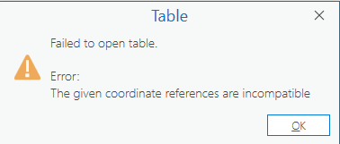

  • On the attempt to open the layers attribute table AGP return the following error message:
If I leave the SRID as unknown, then the layer is correctly visualized.
