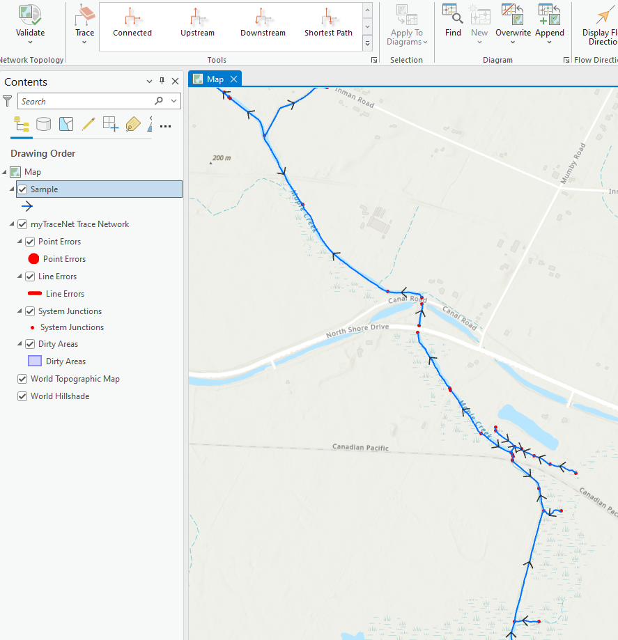

All that said, you did provide a sample of data. I imported your data into a file geodatabase  featuredataset built with the same coordinate system as your sample data. Ran the create trace network and enable network topology using just default settings. No errors, they ran to completion (just a few seconds).
I was able to run the trace tool but the results were poor and that is due to the quality of this dataset. Look at the screen shot below, the river flow directions are pointing u/s and d/s. There are many breaks in the network as indicated by the red points which are the nodes of the network. You can clearly see it breaks at roads and other features.
I would deem this network untraceable, but I still did not get the error messages you were getting. I'm using ArcPro 3.3.1
You need to close the gaps, or get the originator of this data to resupply you with a fully connected network. But that would not explain the odd error messages you were getting. There is something about how you are setting this up or a version issue that you need to resolve.
