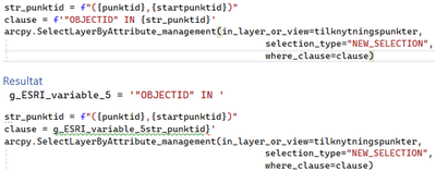

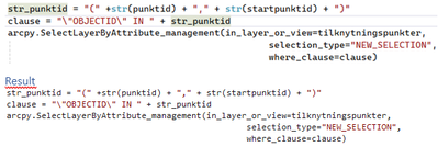

I've done some more testing on this issue, and I found a workaround. In ArcGIS Pro 3.3 we need to use ordinary concatination and not f-string, even though f-formating worked ok in ArcGIS Pro 3.2.
I was using a f-string in a where_clause for SelectLayerByAttribute, and in my first test I tried changing this into a new variable with f-string. When running the tool, the variable str_punktid was ok but the clause was wrong (see the picture)
When changing to ordinary string concatination, it works fine:
