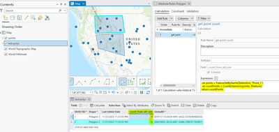

DrewFlater
I have my polygon feature class and point feature class (Point_1) in the same geodatabase. And set up this immediate calculation attribute rule on inserts. So when I draw a new polygon, it automatically calculates the number of intersecting points and puts it into the count_from_att_rule field.
var points = FeatureSetByName($datastore, "Point_1")
var countPoints = Count(Intersects(points, $feature))
return countPoints
