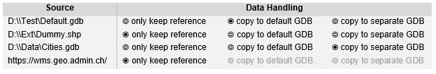

The extremely tedious diversions via UNC paths is by no means satisfactory for me, but at least it works. However, I do not understand why data handling is not simply left to the user when creating project templates. for example, with a simple and clear listing of all sources so that I can control my desired handling for each source individually.
e.g. like this:
Whether a path is actually available on another computer on which the template may then be used should be my problem and not that of APRO.
If a path does not exist, the user/employee can fix it as usual. This is especially interesting if users have saved image data locally on their computers for performance reasons, but other project data is on network drives. In this way, I can integrate the image layer itself into the template, and each user adjusts the path individually when using it for the first time.
