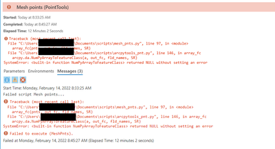

Also, using the tool Mesh Points from your github, I get the below error. Do you have any idea what I'm missing?

Create Fishnet (Data Management)—ArcGIS Pro | Documentation
should raise that error, try saving the output to a shorter path.
You are running the tool from the toolbox installed in a path with no spaces? from inside Pro.
Both issues suggest access to arcpy issues and/or path problems to the local file geodatabase
