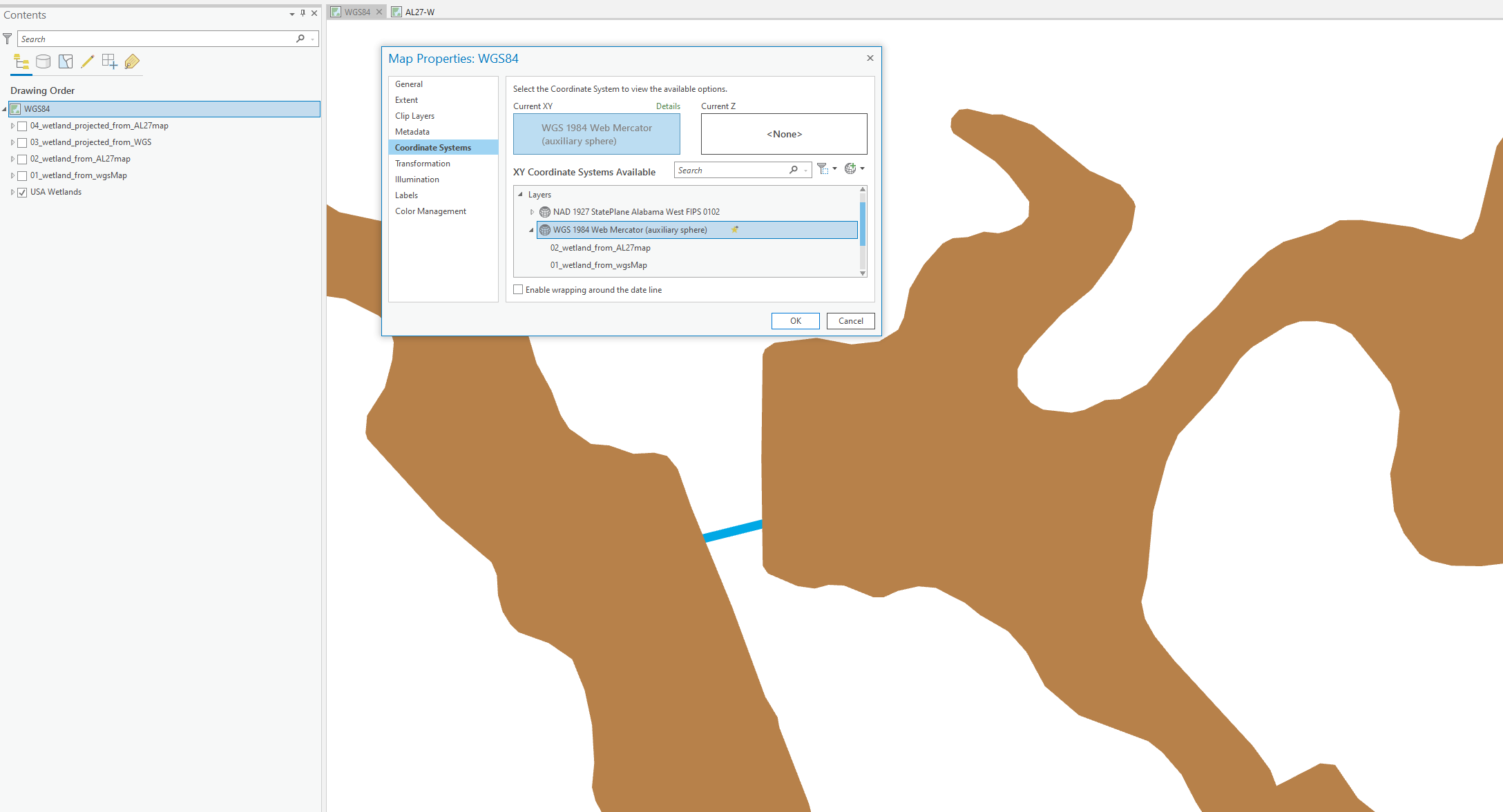

  • Map 1 Coordinate System is WGS1984

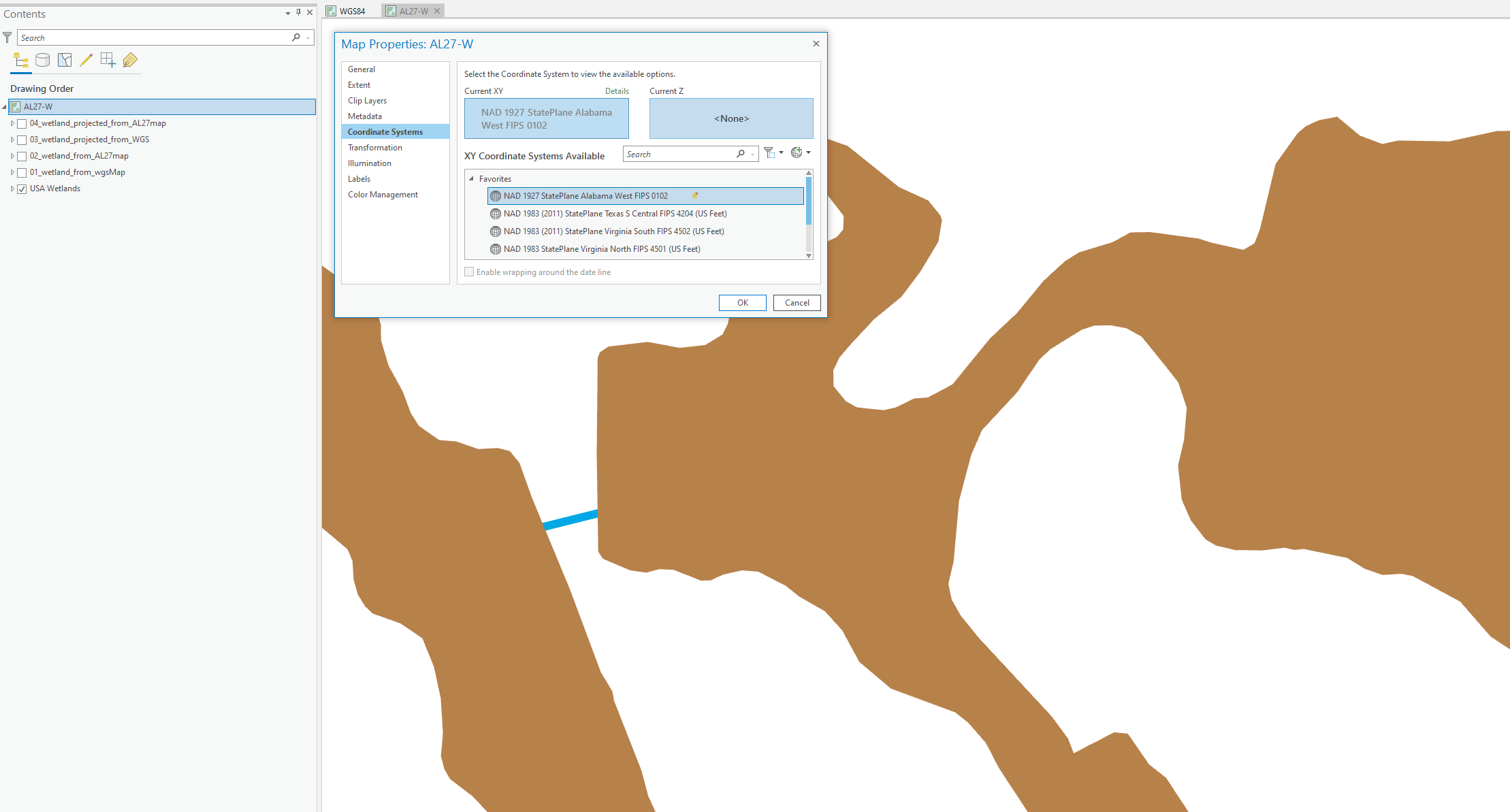

  • Map 2 Coordinate System is State Plane NAD27 Alabama West US Feet

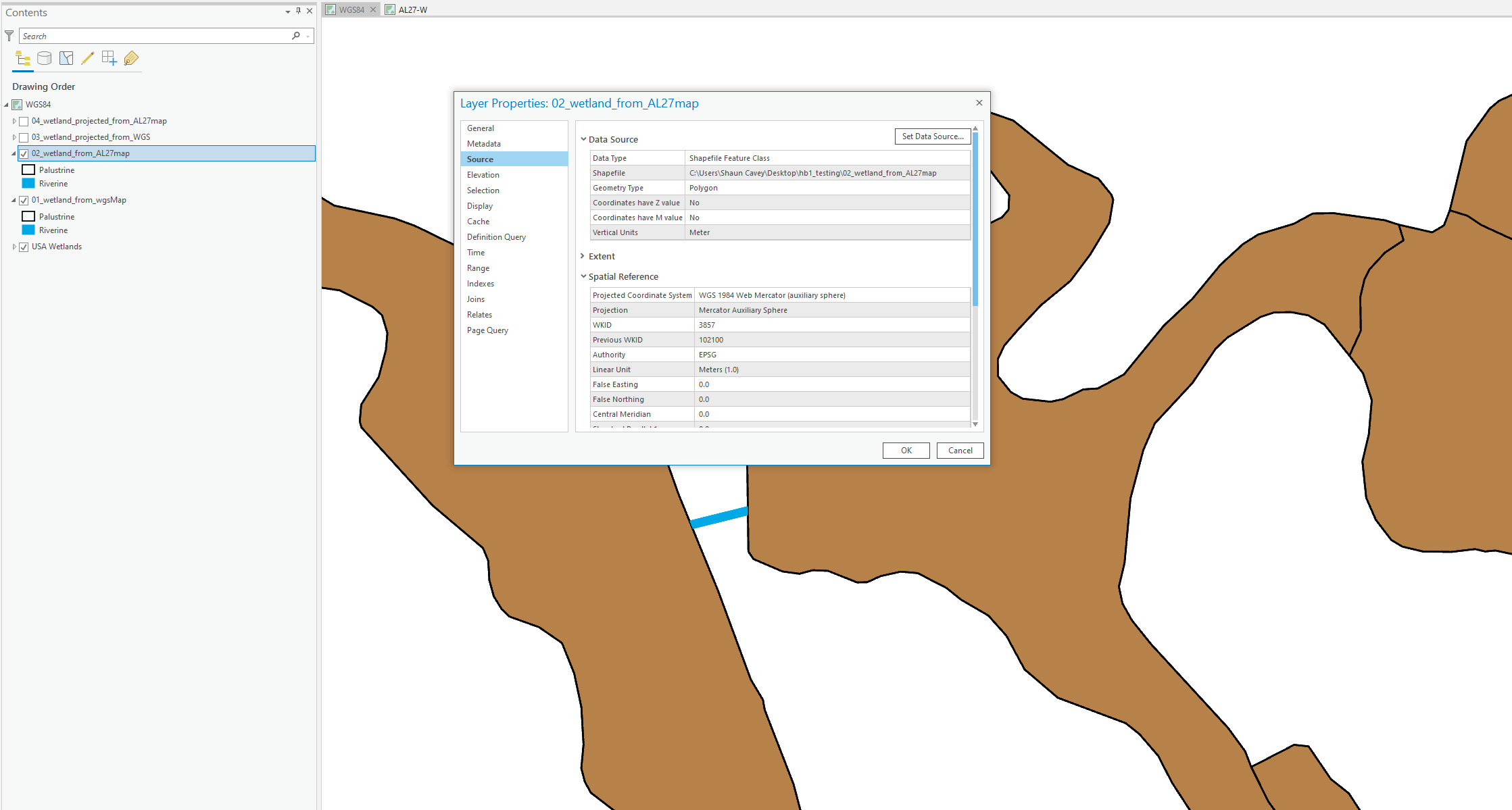

Results – Both shapefiles are aligned with original NWI Wetlands (as expected) in both Maps.  They are essentially the same shapefile.

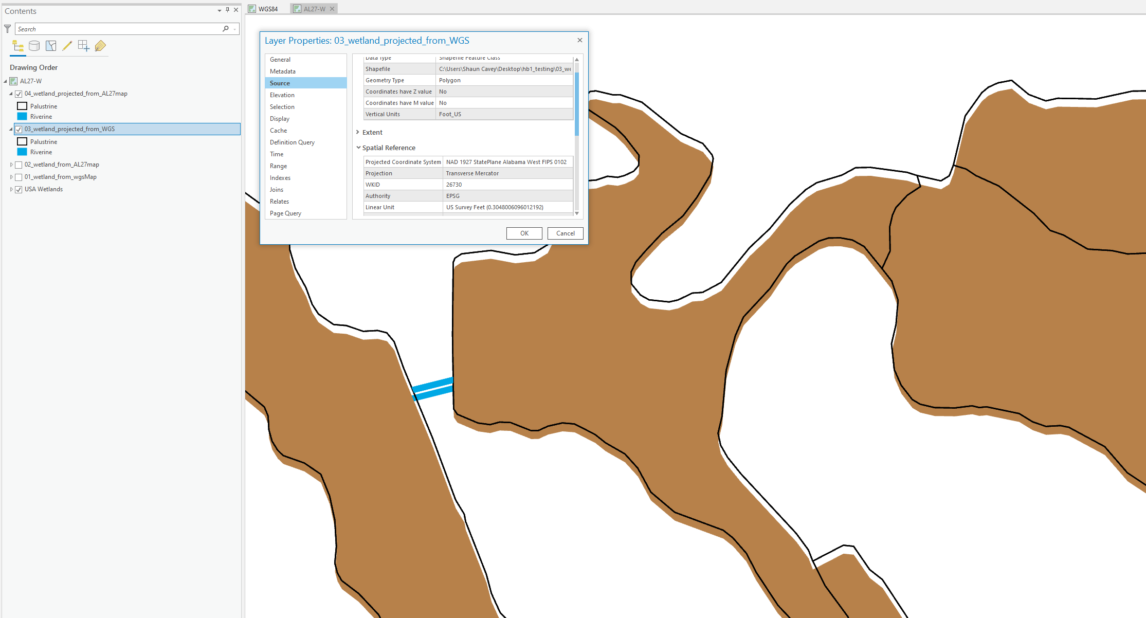

Map 1: Both Projected shapefiles are aligned with NWI Wetlands, as expected.

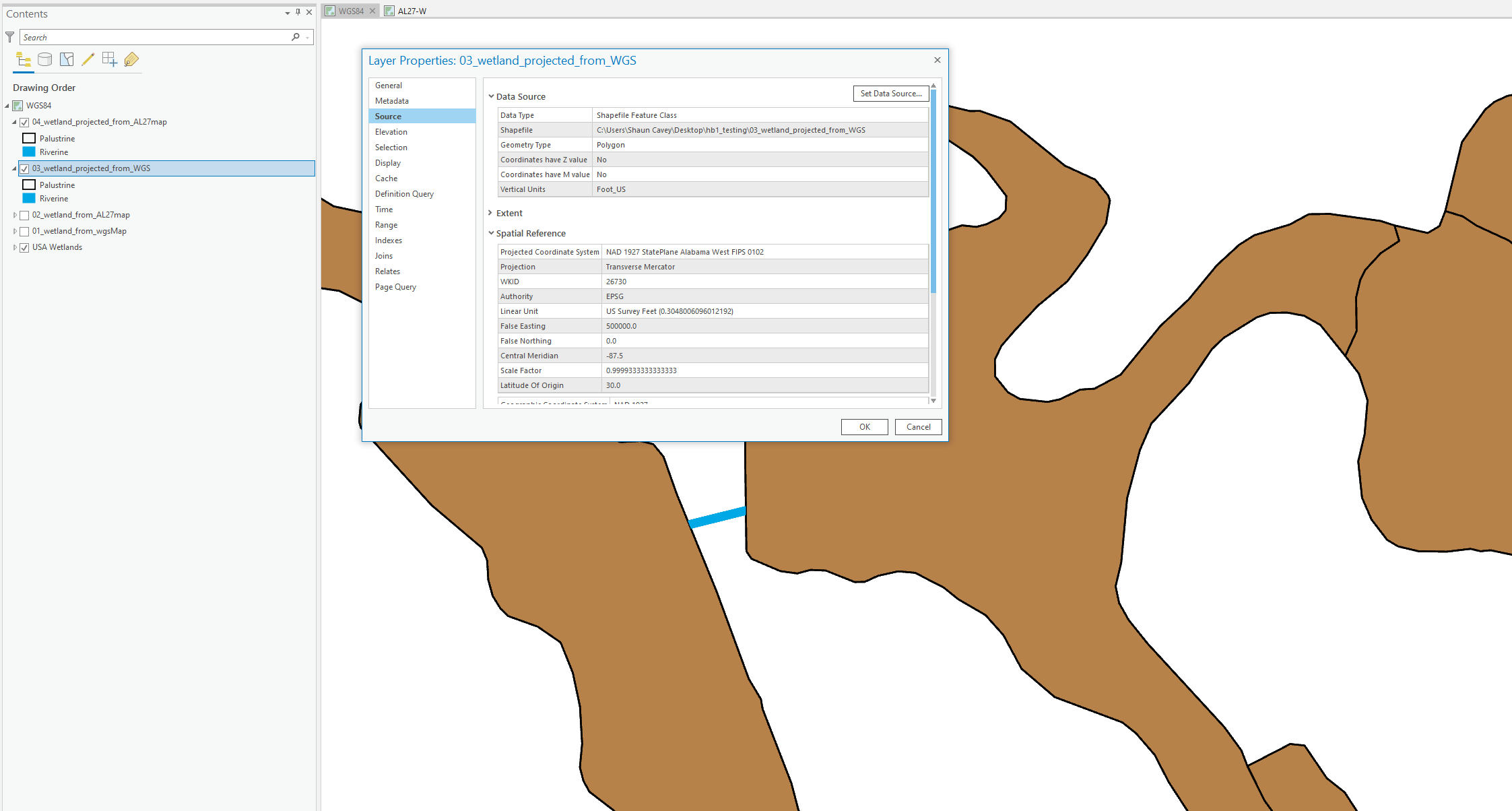

Map 2: Both Projected shapefiles are shifted about 35.2 feet from the NWI Wetlands, this was unexpected.  What is going on?!

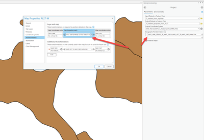

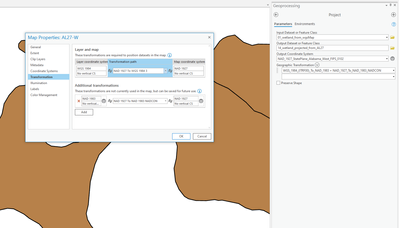

There was a mismatch in the The Map Transformation Properties versus the Geographic Transformation Parameter of the Project Tool.  These need to be aligned!

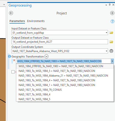

What's interesting, is that the Map Geographic Transformation (NAD 1927 to WGS 1984 3) was not available in the Project tool dropdown choice (screenshot below).  I think this was the root of the problem.
Bad
Good - Aligned, same transformation.
No - NAD 1927 to WGS 1984 3 available

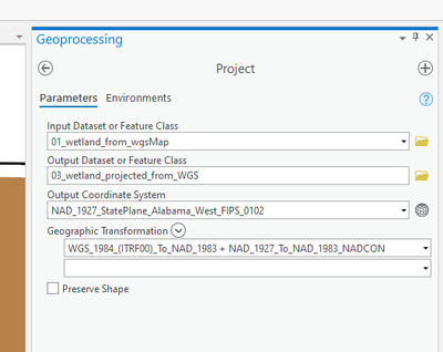

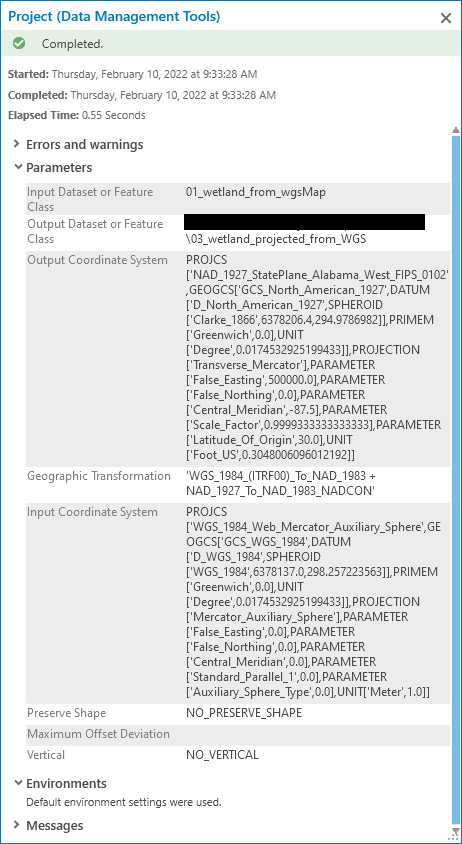

Below is a screenshot of the Project Tool parameters.  Once I set the Output Coordinate System I wanted, the Geographic Transformation was auto-populated.
Question:  Does the Geographic Transformation auto-populate from the Shapefile or the Map Properties?
Is there another step I'm not thinking about?

autopopulate assumes that the inputs were defined correctly, and it does its best to provide a selection of possibilities (was there more than one transformation offered? check the tiny drop-down arrow beside ...NADCON).  I don't know what would be best for your data, but the correct data definition and correct transformation will produce unshifted data
