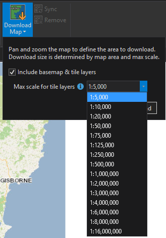

When trying to create a map tile package in Pro 2.3.1 I'm running into a "Layer type is not supported: layer name" error for a cached map service. I can't run it via the geoprocessing tool as it hangs so I'm using the Python window. I've tried both an ArcGIS Online basemap and a locally hosted cache map service (configured for allowing clients to export 5mil cache tiles). Both basemaps I can use the 'Download Map' tool with to create a tpk but that limits the scales for a given extent - which I thought was due to the number of tiles to export setting but appears not to be - so I can't create a tpk with the extent I need with all the scales.
Why does Download Map (to create a tpk) work with the same layers which the Create Map Tile Package doesn't support?

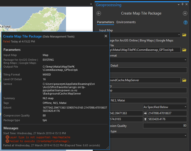

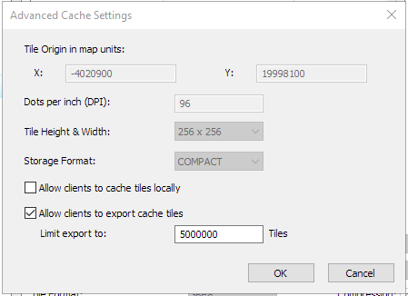

Kory Kramer‌, Joel Whitney‌ any ideas on this one? I'm using Pro 2.3.1 and trying to create a TPK using the Create Map Tile Package GP tool. The service is a locally hosted cached map service (10.5.1) with settings for exporting 5mil tiles. Using the Download Map option I can't get a low enough max cache scale and if I try to use Create Map Tile Package I get this 'Layer type is not supported: ' error.
Max scale I need is 1:1000 (LOD 16 for this service)
Error I get when using Create Map Tile Package
Cached service config:

If you go to the service's REST endpoint, do you see that exportTilesAllowed is true?  This is getting a bit outside my area of expertise, so I don't know if it might have anything to do with this bug that I found:

Yes, at the REST endpoint I can see the ExportTiles option (image below). It's also not a hosted service so I don't think we're impacted by that bug. I'm intrigued by what the 'Download Map' function is doing compared to the Create Map Tile Package tool, as they must be coded differently for a very similar function.
