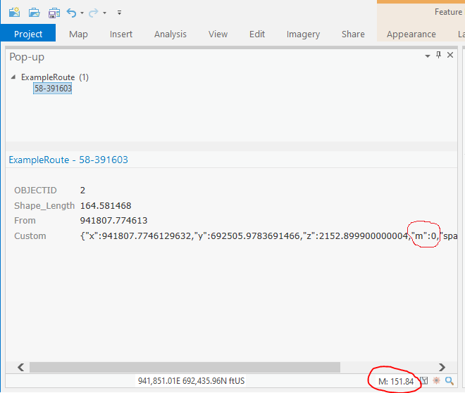

Hi All - I see that it is possible to access x,y,z, & m values for a custom pop-up using Arcade. The code below appears to be working in ArcGIS Pro 2.5.0 per my route layer:
var line = Geometry($feature)
var paths = line.paths;
var startingpoint = paths[0][0];
return text(startingpoint)‍‍‍‍‍‍‍‍
However, I'm not yet understanding how to return the m-value for any point along the route that was clicked, rather than the centroid or endpoints.  The m-value I'm looking for appears in the pop-up panel at lower right in ArcGIS Pro 2.5.0 (see pic below).
Any assistance appreciated!

NickHarvey
Thanks for chiming in Ben - You're right...I can get to the m-value for the starting point of the route by replacing "x" with "m" for example...But I'm chasing the m-value for any point along the route, as it appears at the bottom of the pop-up panel at 2.5.0 where the route is clicked.  My idea was to build a calculation(expression) in the pop-up which uses this m-value as a variable.  The m-value is being populated at the bottom of the pop-up panel.  I'm not understanding how to reference it into the pop-up body though (?).

    NickHarvey
    Hey thanks for responding Nicholas - No progress sorry to say...Yeah, my guess is that it is not the right approach for retrieving m-values dynamically along the line because our Arcade expressions above each refer to a specific vertex (?).  As my picture above depicts - m-values do show up in the standard popup though (at bottom right)...I wonder about SDK (?)
