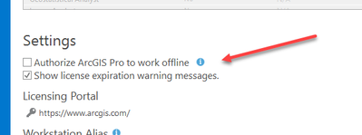

Yes - when I say it needs to be manually checked out again. Basically, when there are issues with the license, when you log in as that user, the "Authorize ArcGIS Pro to work offline" option has become un-checked. Manually checking that option and closing ArcGIS Pro fixes the issue.
