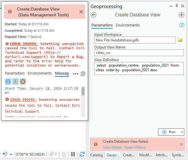

Background:
In a mobile geodatabase, I can create the following database view without issue:
select
    population_centre,
    population_2021
from
    cities
order by
    population_2021 desc
But if I try to create the same view in a file geodatabase, then I get ERROR 999999:
The culprit seems to be the ORDER BY clause. If I were to remove the ORDER BY, then I could create the view.
select
    population_centre,
    population_2021
from
    cities
But that would defeat the purpose of the view: to sort population_2021 (descending).
I'm aware that there is a Sort geoprocessing tool. But I don't want to use it since it outputs a static FC. I want a dynamic query.
Related:
Esri Case #03531064 - Create FGDB database view using the ORDER BY clause: ERROR 999999
...this is a known defect that will sadly not be addressed at this time. The 'ORDER BY' parameter must not be used as a part of a view as it is not supported on all views in many data sources. This applies to a file geodatabase and many RDBMS, for example, Oracle.
BUG-000133228 The Create Database View (Data Management) tool fails when a derived field is used in the ORDER BY clause.
BUG-000134186 The 'Create Database View' tool fails to create a new view, and returns an error message, "Error 999999: Something unexpected caused the tool to fail." when the 'ORDER BY' parameter is used for a file geodatabase in ArcGIS Pro.
Question:
Are there any workarounds for this issue?
Bud
Legendary Contributor
I can wrap it in an outer query:
select
from
select population_centre, population_2021 from cities order by population_2021 desc )
Now, I can create the view without issue. The ORDER BY works as expected.
