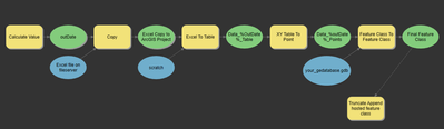

I do something similar with Excel data that is populated by a co-worker and then published to ArcGIS Online by truncating and appending the existing hosted feature layer.
I used modelbuilder to make a model that runs the Excel To Table tool, then XY Table To Point using a calculated date in the feature name, then Feature Class To Feature Class, essentially to overwrite my existing local feature class that is used to append to the online version.
I created a script following the recommendations here https://community.esri.com/t5/arcgis-online-documents/overwrite-arcgis-online-feature-service-using/...  and added a tool to the model that points to that script, (Truncate Append tool in model below)
I have attached the script from the community post above.
When updates are made to the Excel file I manually run the model.
Carl

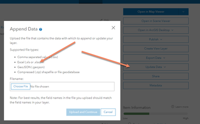

If you are just trying to add new features to the layer, can't you just use the "Update Data" option in the hosted Feature Class details page?
Should append any data from the excel file to the layer.
