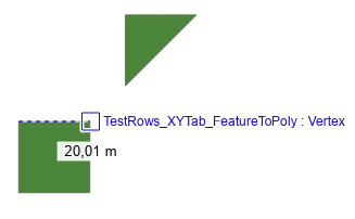

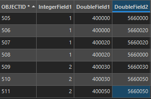

Be aware that measuring gives very different results based on your map's coordinate system, the data's coordinate system, and the measuring method.
For example, in the images above, I measured the distances using the planar method, while both map and feature class are in the same projected coordinate system.

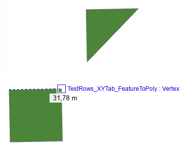

Here is that measurement using the geodesic method:
And here is the planar measurement while the map is in the WGS1984 system (geographic):
