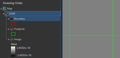

I have created a mosaic dataset using 'create mosaic dataset' and 'add rasters to mosaic dataset' using defaults.
The output has the range shown below and the appearance is just uniformly gray. The inputs looks fine. The minimum and maximum values of the mosaic dataset are more logical (800ish to 1,000ish)
Where is this range of values coming from?
The mosaic dataset seems to work in that it creates legitimate-looking slope surfaces, but the image itself looks weird.

The mosaic dataset doesn't know the min/max yet, that's why it shows the full range. You need to calculate the statistics.
Brand-new mosaic:

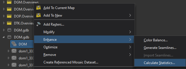

Calculate Statistics

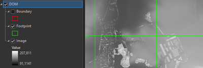

After:
