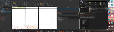

I have created a GDB and then created a blank Mosaic Dataset.  I added raster's to it, then went back a little later and added some more but when they came in, they were blacked out. So tied some more but same thing happened again. Anyone know why that keeps happening and how to fix it.  Help Please!

This happens to me sometimes too. I think it has something to do with the connection to the database where the mosaic is stored. Have you tried removing the mosaic and then re adding it to the map? That's what I do and it reestablishes the connection.

Now I get this error?
JerryClark4
Update: I finally got it to work, but I had to use the create a catalog dataset tool. Then loaded the raster into this file and everything displays now. Hope this solution will help someone else. Thanks for the suggestions I got from the community.
