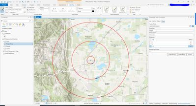

Robert_LeClair
Esri Esteemed Contributor
Using ArcGIS Pro Intelligence, I used the Direction and Distance command to create 1, 5, and 10 km buffers around a selected airport.  Then used the Contour label placement option with downhill label alignment to get what you see below.  Is this what you're attempting to create?
