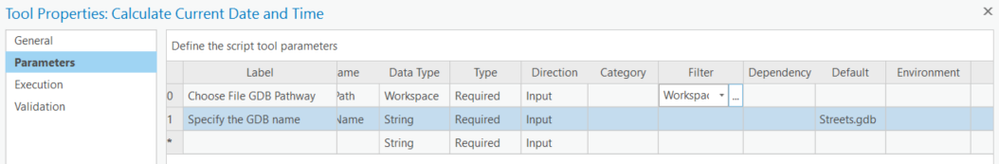

5: On the Parameters tab you need to create 2 parameters here.
The first parameter is the geodatabase pathway.
  1. Provide a label. This is what the user will see as the title of the parameter on the dialog.
  2. Select workspace as the datatype. You should set a filter, choosing workspace and then tick File System
The second parameter is the geodatabase name.
  2. Set a default value, for example Streets.gdb.
So:
The ordering of these parameters on the Tool Properties dialog is important as the order on the dialog determines the order in which the values are passed into the script via arcpy.GetParameterAsText()

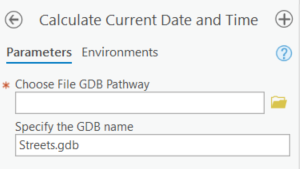

7: Once your are finished double click the Python Script tool:
The script tool dialog will then display.
8: Fill in the dialog parameters and press Run.
That should be everything you need to know... and will create a new file geodatabase with the current date as part of its name...
