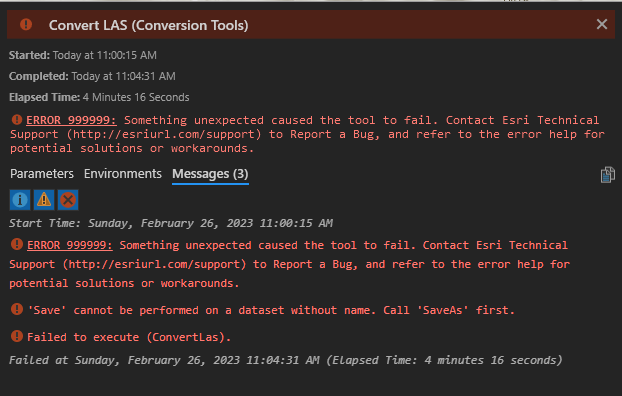

I have a series of LAZ datasets that I need to convert to LAS so I can create a DEM. I've tried processing an entire quadrant of a quadrangle at once, and then a single LAZ, and each time it's stuck at 2% indefinitely. I've had the process running for 2 hours and it didn't budge.
At first, I thought it was a hardware issue because I had just over the bare minimum RAM required, so I upgraded that and still had the problem. However, I've found a post on StackExchange where someone was having the same problem. Additionally, when I re-tried the process this morning with a single LAZ file, I finally received an error message, which really told me nothing. I can run other processes just fine, but this one is just not working at all.

Unless I'm missing something from that workflow where the poster was also unable to process the tool at all, it won't. The issue I'm experiencing prevents me from even completing the first step of that workflow.  I am completely unable to use the Convert LAS tool. It will not complete processing. It's either stuck on 2% for hours, or it throws the attached error message.
