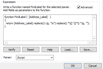

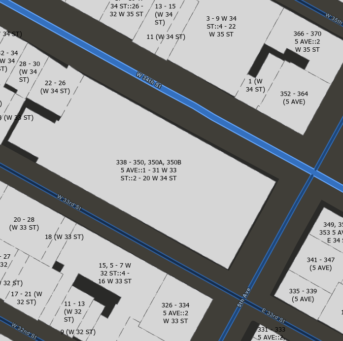

Hello,
I have a JavaScript label expression that I am having trouble converting to ARCADE. The label expression is addresses for New York City Buildings. Since some buildings have multiple addresses the ability to minimize text is essential.
In the label field are parenthesis and since ARCADE uses parenthesis i can't figure out how to represent them as text.
Here is the label expression in JavaScript:
function FindLabel (  [FIELDNAMEl]   )
  return [FIELDNAME].replace(/::/g, "\n").replace(/ *\([^)]*\) */g, "");
JavaScript Version
In ARCADE I currently have the label expression looking like this:
Replace($feature.FIELDNAME, '/::/g/ *\([^)]*\) */g', " " )
Arcade Current
Parenthesis need to be removed from the label as well, which should remove the street name, for example, (W 34TH ST).
All types of characters should be replaced with nothing. I want to minimize code as well.

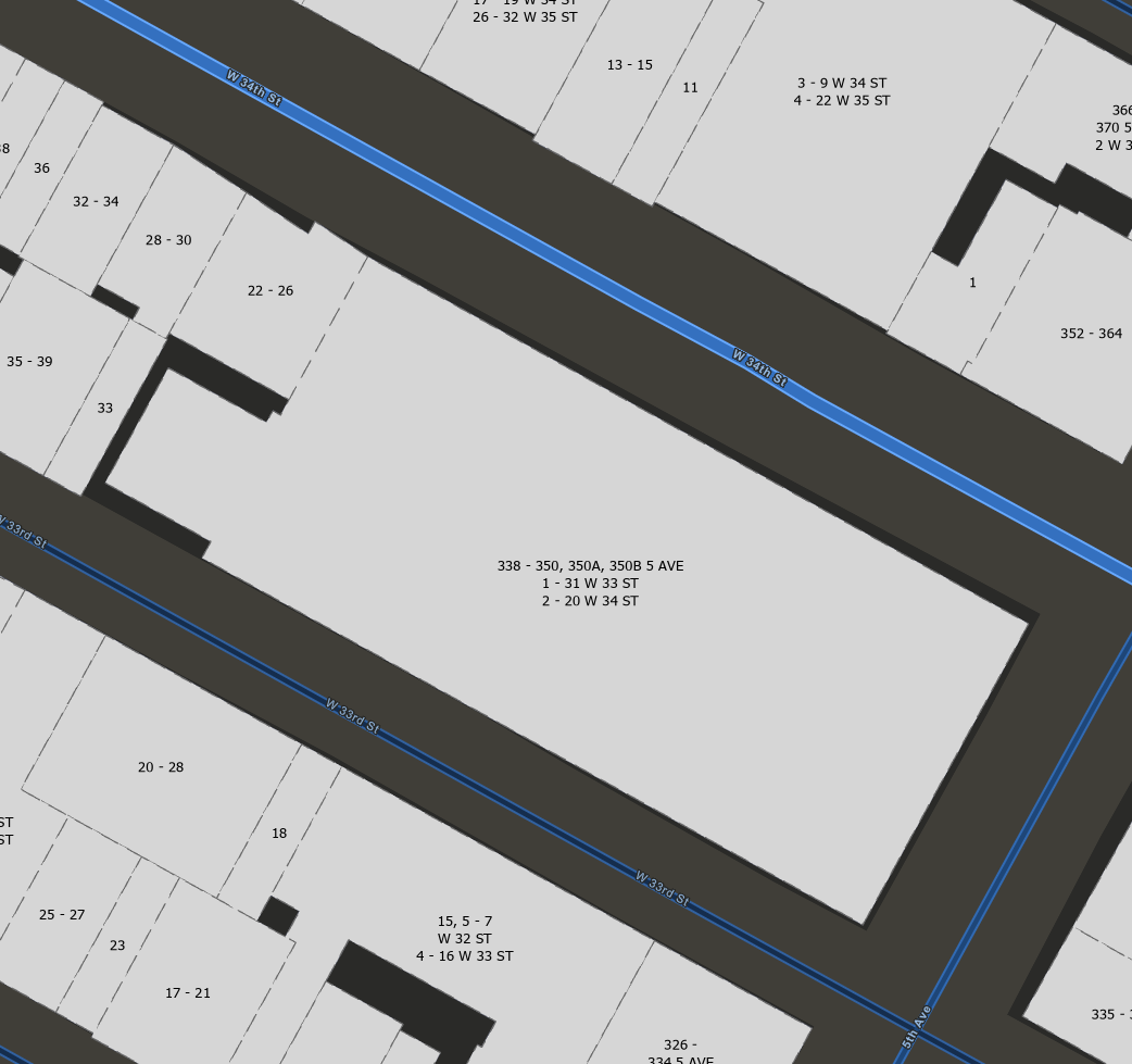

I assume you are trying to convert a VBScript label used in ArcMap (?) to an Arcade label in ArcGIS Pro. Is that the case?
Have a look at the test code below:
var input = "338 - 350, 350A, 350B, 5 AVE::1 - 31 W 33 ST::2 - 20 W 34 ST";
var input = "352 - 350 (5 AVE)";
var input = "1 (W 34 ST)";
var input = ")123^*[]";
// remove all after (
var result = Trim(Split(input, "(")[0]);
// Replace :: by new line
result = Replace(result, "::", TextFormatting.NewLine);
// Replace charctars
var remove = ["\\", "(", "[", "^", ")", "]", "*"];
for (var a in remove) {
    Console(a);
    result = Replace(result, remove[a], "");
return result;‍‍‍‍‍‍‍‍‍‍‍‍‍‍‍‍‍‍‍
as result:
returns:
1 - 31 W 33 ST
2 - 20 W 34 ST
"352 - 350 (5 AVE)"
returns:
352 - 350
"1 (W 34 ST)";
returns:
")123^*[]";
returns:
123

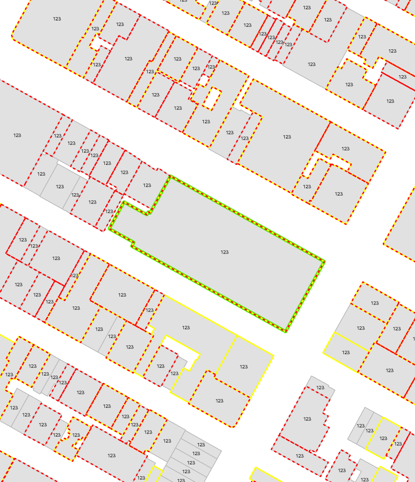

JohnBrockwell
Hi Xander Bakker
Thank you for your assistance.
Yes, I am trying to bring an ArcMap label expression (below) into ArcGIS Pro and ArcGIS Enterprise / ArcGIS Online.
I brought the expression into ArcGIS Pro from ArcMap.
When I ran your code in ArcGIS Pro using Arcade the buildings were all "123".
Not sure where the disconnect is?
Thanks again,
JB
