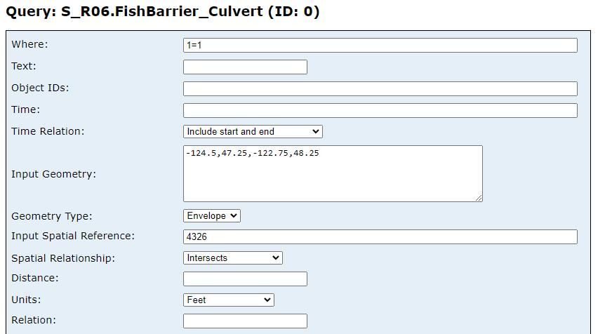

Actually, it's not that hard. The input in the Input Geometry box can simply be a XMIN,YMIN,XMAX,YMAX list of coordinates, separated by commas. Below is what I used to query all the records found on the Olympic Peninsula:
I used WGS 1984 as the spatial reference for my lat/longs (that's the 4326 number that is specified). Just figure out your bounding box and use those values which should give you what you need.
