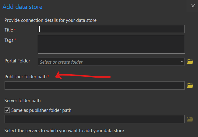

I believe that ArcPro thinks that this path in my python script is a folder, NOT an .sde file. When I click the "Register Data Source With Server" after analyzing the script, it pulls up the form to register a folder (screenshot below), which looks different than the form to register a database. I don't know why this would be happening as the path in my script is clearly an absolute path to the .sde file. The path in my script is below. The path does not include the <> characters, I have obfuscated some of the values.
connection_file = r'C:\Users\<user>\Documents\ArcGIS\Projects\<project>\<connection_name>.sde'

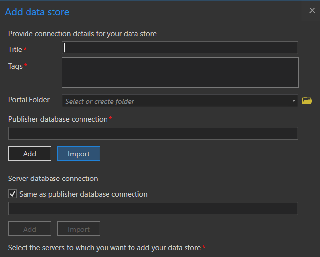

Register folder menu (This is what pops up when fixing via the 'analyze' results):
Vs Register Database menu:
