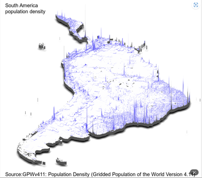

I am trying to generate a map with a 2D raster as basemap (observed landuse) and overlay it with 3D error bars (containing the incorrect land use categories that model predicted). So it involves conversion of one of the 2D files to 3D first
I have been trying both in arcgis pro and arc scene
  • In Arc Scene I first created a height column in attribute table as the raster doesn't have elevation information. when I tried this link and increased the value of vertical exaggeration, it also changed the 2D base map which I wanted to keep as it is.

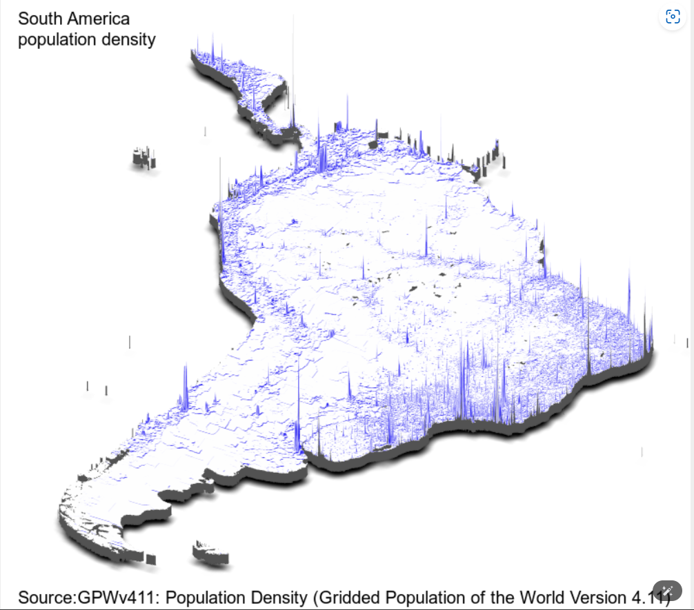

    I am looking to get something like the map at the bottom but the vertical bars come from a different raster with the same spatial boundary as base map
    • The python code I have been using looks like below and it gives me a map skipping the basemap completely and very high error bars. I am trying to figure out what am I missing
