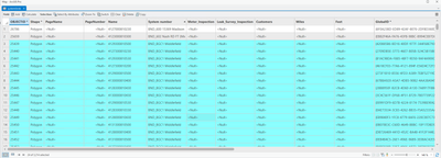

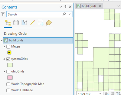

How do I combine multiple grids using python without having to create a new layer ?

Hi Kepa,
The grid index creates an entirely new layer which is something that I can't utilize because we have over +200 systems and approx. +3000 grids. There is the edit merge tool but I would have to manually select each and every system and grids to merge which is difficult doing this by hand each week. Is there a way or tool to select features in the same feature class and merge grids without having to create an entire new feature class?

Ok, I was misunderstanding your goal here. You are talking about merging grid features of the same feature class and not grid feature classes, is that right?
neomapper
Yep, grid features of the same feature class!
Kepa
by Esri Contributor
So looking at your table I assume you want to merge them by system number field. The "easy" way would be (you'll have to deal with python logic a bit):
  1. Dissolve by system number field, this will create a temporary feature class with the features merged by its value.
  2. Create a SearchCursor for dissolved feature class storing system number value and SHAPE@ object in differente variables
  3. Create an InsertCursor for your existing grid feature class
  4. For every system number value from SearchCursor apply a Selection by attribute on your grid feature class and execute DeleteFeatures.
  5. Finally add/insert the shape and system number value into your existing grid feature class with the InsertCursor (the rest of the fields would be Null of course, although I see only Name field has values)
  6. Delete temporary feature class
Hope that helps!
