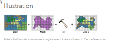

If you did create your heatmap as a raster using Point Density or Kernel Density, another thing you can do is actually an environment setting before you run the Point Density or Kernel Density.  It's called Mask, and it will limit the output of your tool to just your desired area.
https://pro.arcgis.com/en/pro-app/latest/tool-reference/environment-settings/mask.htm
Or you can run Extract by Mask after the fact.  The mask can be a polygon.
https://pro.arcgis.com/en/pro-app/latest/tool-reference/spatial-analyst/extract-by-mask.htm
