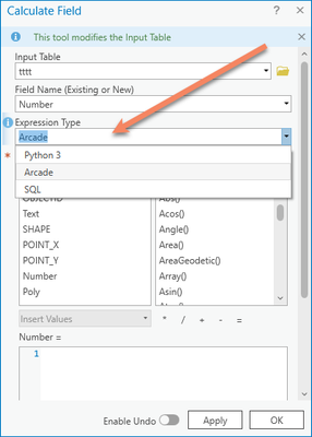

I've never used Arcade. Curious to know where exactly do I write the code?
RhettZufelt
MVP Notable Contributor
Arcade Function Reference
