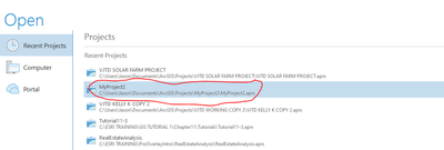

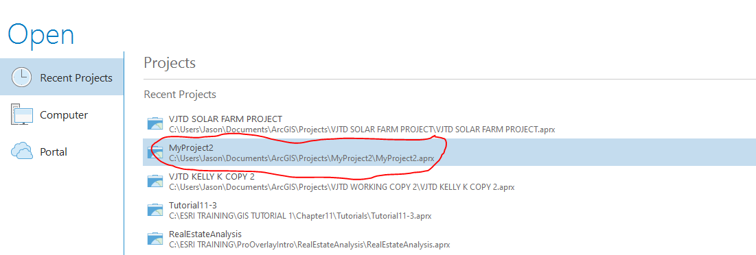

Hi,
Can someone show me how to change the name for a project file? For instance, I would like to change the name for "MyProject2" to something else, can I go the folder location where the .aprx file is stored, in this case is MyProject2 and change the name of the .aprx file to something else. I already have a DEM, shape files and raster datasets created under this project and am wondering if these files will be affected if I change the name of the .aprx file?
