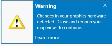

Changes in your graphics hardware detected. Close and reopen your map views to continue.

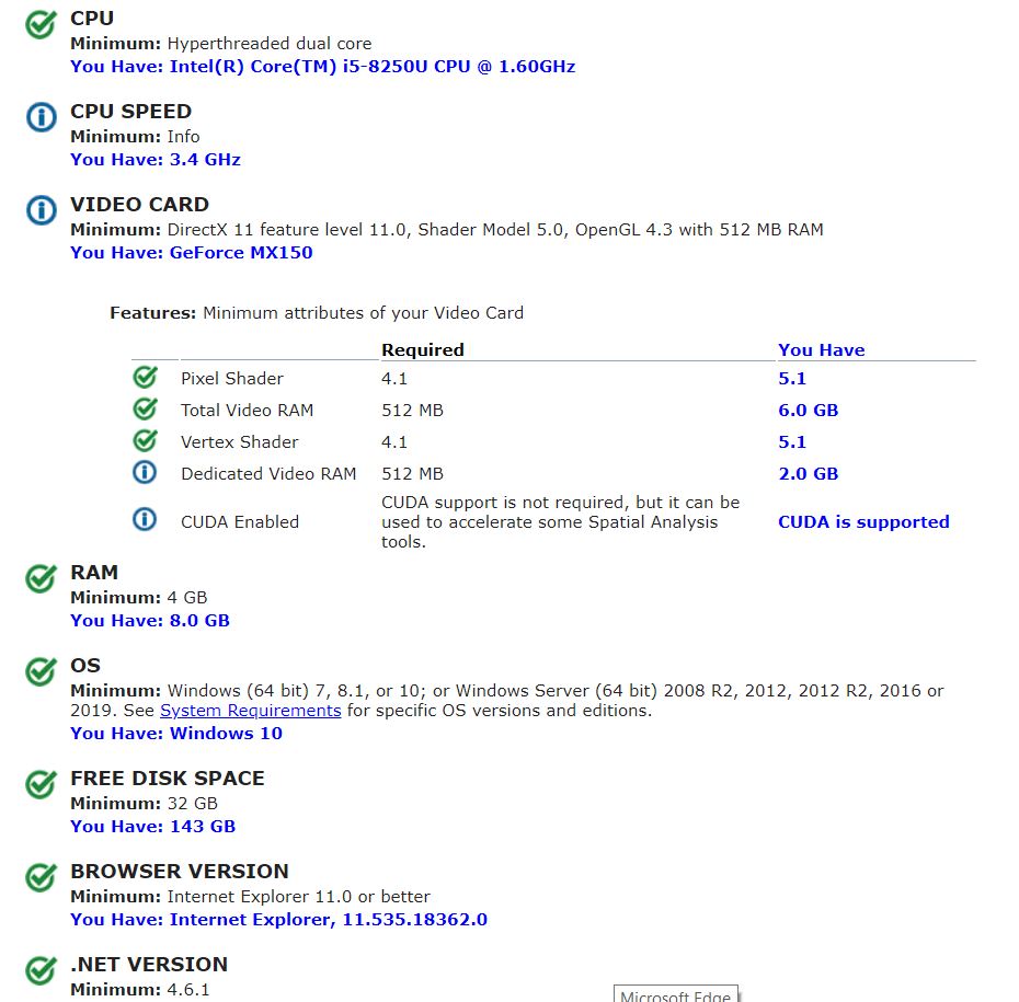

I get this message every time I try and open a map. Any help would be greatly appreciated, at the time being I cannot even begin to use the program due to this issue. All my drivers are up to date. I took the test to see if my laptop could run ArcGIS Pro and it passed with no issues (results below).
Any suggestions?
