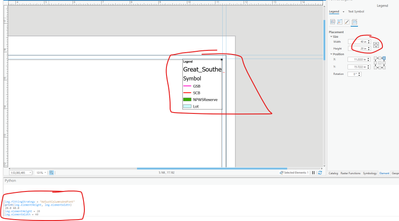

DavidField
Apologies Mehdi,
I was pulled onto some other projects and have only just gotten back to this thread!
I tried the supplied code, however while I observed the fitting strategy set to "Adjust Columns and Font", and the legend size changes to 40w and 20h, neither the legend size changes, nor do any of the font sizes seem to change. Am I doing something wrong?
I am sure this has been uttered many times before on these forums, but does anyone know why on Earth ArcGIS Pro arcpy doesn't have a "fontSize" property?!?!
