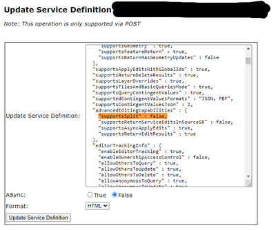

Looking into this issue with Paul, could anyone confirm what this setting in the ArcOnline JSON editor might be? I can't find anything through the Googs.
We know the layer already supports splitting, and I'm unaware of how/where these settings are relevant.
