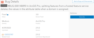

found this item in ArcGis Pro 3.0 "issues addressed"
"BUG-000148890 In ArcGIS Pro, splitting features from a hosted feature service deletes the values in the
attribute table when a domain is assigned"
ArcGIS Pro 3.0 Issues Addressed (esri.com)
have not updated to test yet.

Cool!  I haven't updated yet either.

Yeah.  It does look like they have fixed the bug.  We haven't tried it either.  However, as an interim fix Esri gave us a patch up process that has done the job for us.  Go to the below thread to see the details posted by my colleague.  Sorry, I should have posted this earlier!

Well...I upgraded to 3.0 today.  The split tool is still not performing as it did before 2.9.  If you have any domains and the domain policy is not duplicate, it will still wipe out all your attributes with domains.  (If your split policy is set to duplicate, it will work correctly).  I'm fairly certain when I originally published my hosted features I had the domain policies set to duplicate, but when you bring the hosted feature back into ArcPro the policy was changed to default.  Prior to 2.9 this didn't matter - the split tool would still duplicate attributes properly.
