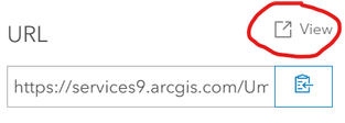

1. Go to your item page of the desired layer.
2. Scroll down to the URL and click View.

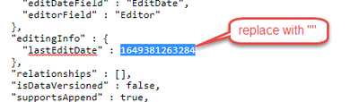

6. Clear the lastEditDate value (replace the value with "")

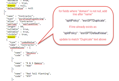

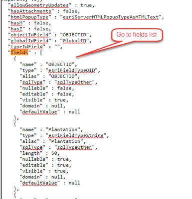

7. Scroll down to the fields list

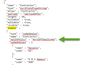

8. Update any field domains where domain is NOT null with the below line of text:
        "splitPolicy" : "esriSPTDuplicate",
 Updated JSON below:
9. When finished, click the Update Layer Definition button.  You should then say the layer was updated.
