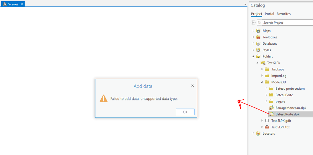

Thanks for the update. The Project Tool is working but we still can't do what we expect. Our goal is to work in a local coordinate system.
Recently, Metashape (formely Photoscan) added a new feature wich gives us the right to export SLPK 3D model in local coordinate as u can see on the images bellow.
However, ArcGIS Pro seems to not support the SLPK with a local coordinate system (last image bellow the text). I think the problem comes form ArcGIS Pro not giving us the possibilities to set a local or unknow coordinate system for the scene.
Steps of 3D Tiled model export in Metashape :
I also tried to export my 3D model in OSGB format in a local coordinate system and use the tool "Create integrated mesh scene layer package" but we still got the same error we had before. You can check it on this topic : https://community.esri.com/t5/arcgis-pro-questions/create-integrated-mesh-scene-layer-package-tool/t...
Do you know were the problem comes from and if local coordinate system will be a thing in a futur patch of ArcGIS Pro ?
