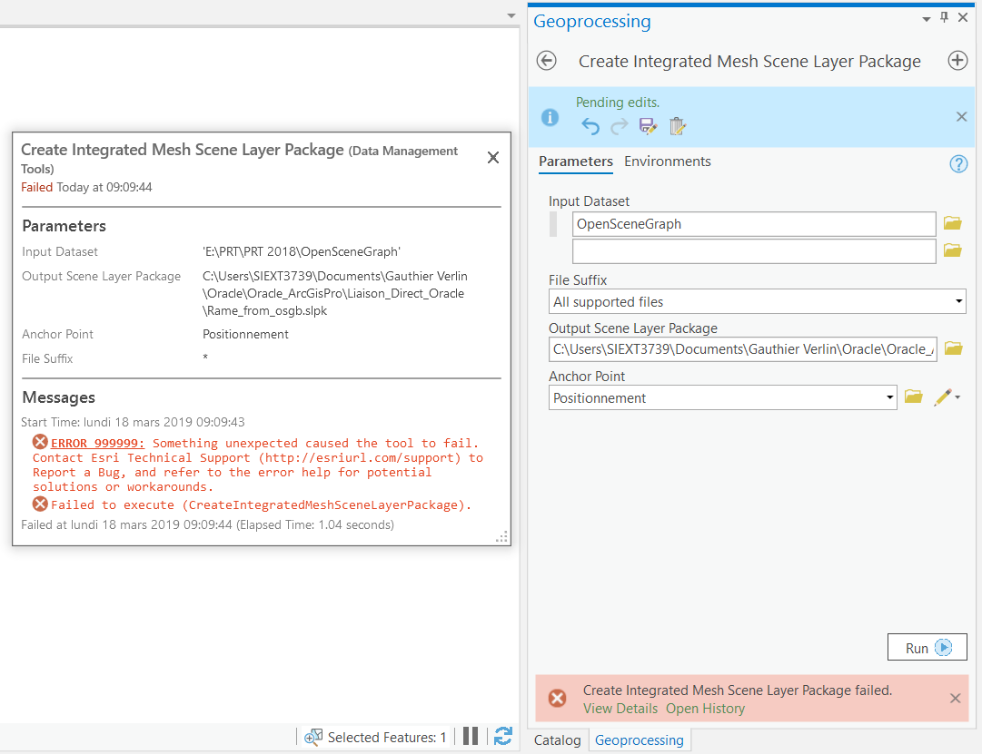

Hello,
I'm trying to use this tool but I can't make it works. I was wondering if this tool works with OpenScenGraph 3d model made with Photoscan.
I have checked all the possible solution to resolve error 999999 but it still won't work.
If you have any idea how this tool works with 3d OSGB model made with Photoscan, I'll be glad to hear about it.
Best regards
Gauthier

I kept it the way Photoscan exported it. Here is the file I try to import :
It's all group into one folder I named "OpenScenGraph" as you can see in the input section of my first question.

Hi Thanks for your patience on this. Our developer was traveling so he just had a chance to look at this yesterday.  It looks like there are variety of issues at play here
1) It doesn’t conform to the well-known naming convention we use (such as the ones context capture generates as below)
 Tile_+010_+023.osgb == > naming here doesn’t matter but child osgb files need to indicate the Level they are (L_15, L_16, if they don’t have ‘L_’ they will be presumed root)
Tile_+010_+023_L15_0.osgb
Tile_+010_+023_L16_00.osgb
Tile_+010_+023_L17_000.osgb
Tile_+010_+023_L18_0000t4.osgb
Tile_+010_+023_L19_00000t3.osgb
Tile_+010_+023_L19_00010t3.osgb
2) We expect children of osg.Node to be osg.PagedLOD ; in this case the root node (Rame.osgb) has a nested osg child node
3) Normals need to be recomputed
4) Some of the faces seem to be inverted
Moving forward we are implementing some fixes in ArcGIS Pro 2.4 to handle these unexpected cases. We will also work with Agisoft directly to ensure the correct information is being output to the OSGB files.
Here's a screenshot of a SLPK that we created and once we do some additional testing with the fixes I can provide this SLPK to you.
