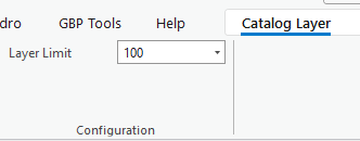

I was expecting it to be in the layer properties window (of which there are three for each catalog layer). It is instead here in the Ribbon:
You can also edit it directly in the LYRX, or using CIM (although I can't find it in the CIM documentation but I'm not looking too hard).

Actually it looks like setting the definition in CIM causes Pro to crash on 3.1 lol. Beware, everyone.
