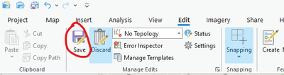

@aurichat wrote:
When I was on my latest one, I had to hit command-z a bunch of times while editing it.
Not sure when you did the series of cmd-z, but that is the undo keyboard shortcut.  Is it possible you undid all the edits before you pressed the save edits button?
R_
