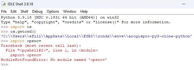

I cannot import python package opencv for use in ArcgIS Pro 3.2

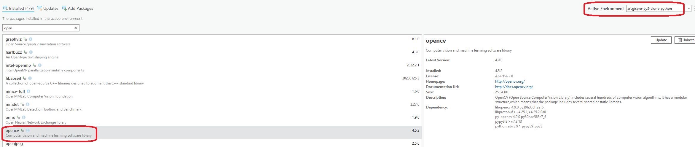

I'm working in a cloned environment that is activated and package opencv seems to be pre-installed.
When importing opencv inPro  or Idle the package is not found.

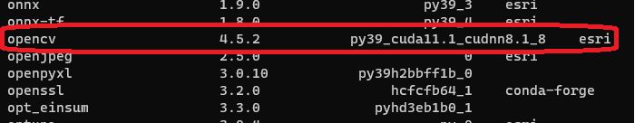

Package opencv also shows up when doing a conda list
I would expect that opencv is accessible for import since it is ocntained in the conda list output.

You are running Idle with whatever Python environment it finds, not the Conda environment. Probably the first Python it finds in your PATH.
Try running this in your Python
import os; os.environ["CONDA_PREFIX"]
If it says KeyError: 'CONDA_PREFIX' then there is no conda environment loaded.  On my computer for example I activated the arcgispro-py3 environment and it says
'C:\\Program Files\\ArcGIS\\Pro\\bin\\Python\\envs\\arcgispro-py3'
Don't use Idle anymore. You should switch to Visual Studio Code or Spyder. I am sure there is a way to make it work properly with Idle but it's not worth the effort, get a better editor.
