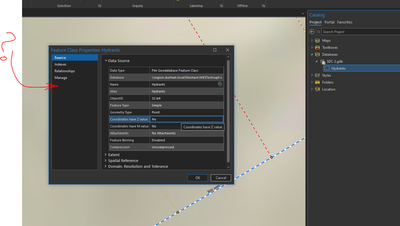

Not sure what is going.  I am following the instructions here (https://pro.arcgis.com/en/pro-app/3.0/help/editing/enable-or-disable-editor-tracking.htm#GUID-DDF021...) to setup Editor Tracking in a FGDB, but I do not have the "Editor Tracking" option even showing up in the Feature Class Properties window.
Is there a setting somewhere I am missing??  This is what I see.

In the Feature Class properties, click on Manage and check.
Enable editor tracking (Screenshot inside for reference)

Hmmm....I wonder why the page I was looking at was different than the one you linked to??  Anyways, that works...thanks!!
