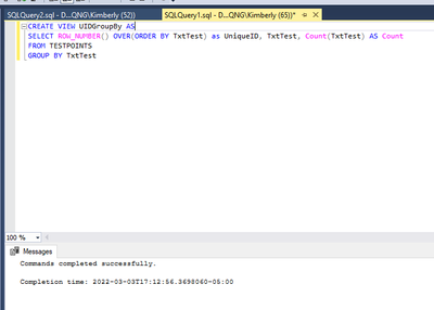

I think this will work... my field is called TxtTest though
This was written is SQL Server but should work  the same:

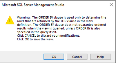

Thank you, @KimberlyGarbade! That partially worked, but didn't get me all the way across the finish line. In SSMS, the query works, but when I try to save it as a view, I get this error message:

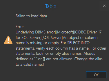

I saved anyway and tried to add the table to Pro, but got this message when I tried to open the attribute table:

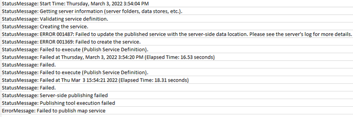

Then I tried adding the actual query as a query layer in Pro. That worked - it added to the map and I was able to open the attribute table and view its contents. But, when I tried to publish a REST service to our stand-alone ArcGIS Server, it gave me several unhelpful errors:

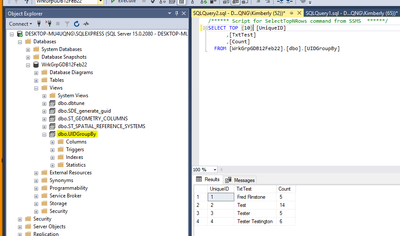

I created the View in SSMS just in a query window and it worked for me:

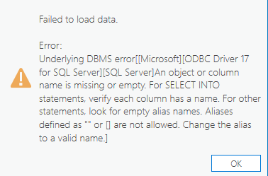

Adding this view to my map in Pro did not work initially, returning this error:

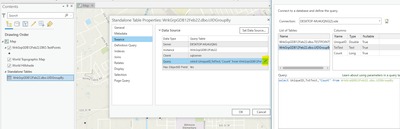

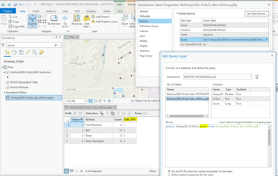

To fix this I opened the Properties > Source for the view in ArcGIS Pro and edited the SQL Query it was using to simply remove the double quotes it had put around "COUNT" for some reason

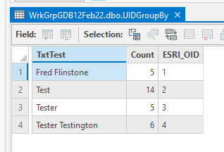

Once I did that the view table would open in Pro, but oddly it added an ESRI_OID field which in effect is what you wanted all along, and makes the "UniqueID" field I calculated in the view obsolete:

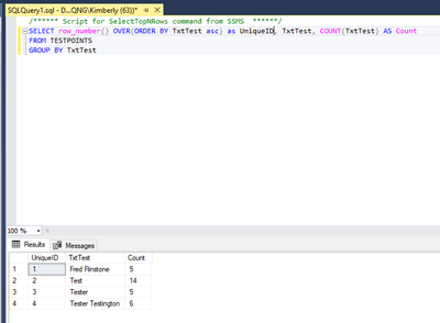

So finally I Altered my view by removed the "Row_Number() Over(ORDER BY TxtTest asc) as UniqueID," part ,re-added it to my map in Pro, and edited the query to remove the double quotes around "COUNT" and got this when viewing the view table in Pro
