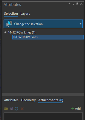

In there, if I have an attachment enabled feature class, and select a feature, I have the ability to add an attachment from the + Add button:

If you were able to successfully enable attachments, like you mentioned in your original post, then the above step should work. I had a similar issue when I used the Attribute tool and Select tool - I did not see the + Add for the attachments. I then realized that the dataset I wanted to select was not actually selected. Can you uncheck the visibility of ALL the layers in your map except for your geodatabase layer and try again?
