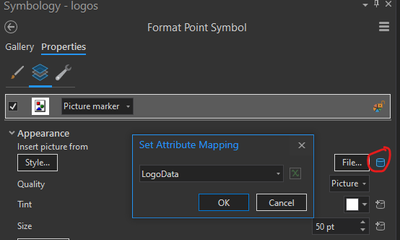

  • symbolize the layer
    • Single Symbol
    • Allow symbol property connections
    • Picture Marker, map File to LogoData, set size

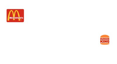

Result:

  • add field LogoData (BLOB)
[Johannes, what does this mean?]
JohannesLindner
MVP Alum
@DavidZiegler Create a new field in the point feature class with the name "LogoData" and the field type BLOB (Binary Large OBject).
Fields of this type can store byte data, so everything you can think of. Images, PDFs, Excel, Word, music, video, etc.
We're going to use it to store the logo files directly in the feature class.
Have a great day!
Johannes

Johannes has provided an effective path here to putting multiple company or other picture (png or other) logos on a map. I can't thank him enough.
