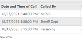

Hi all,
I have a water main break layer published from an Enterprise SDE to portal. My local time zone is Eastern Time (which is UTC-5). I pulled the feature service from Portal into Pro to do some editing. I edited the Date and Time of call, but for some reason, only one record is a single hour off in Portal from what I entered in Pro. It's not the UTC conversion, because that's a 5 hour difference. The first two records came in just fine at the correct time. I'm so confused.
What I see in Pro (3rd record says 3:15):

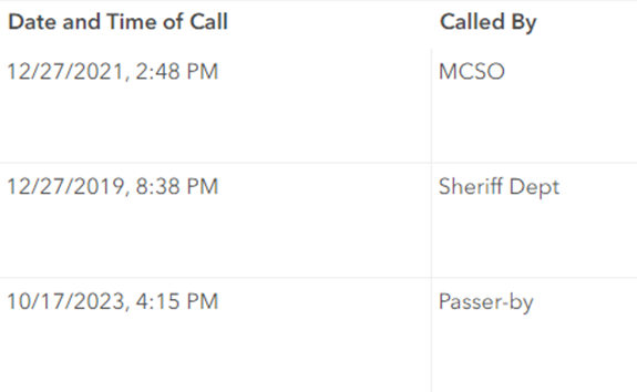

What I see in Portal (3rd record says 4:15):
