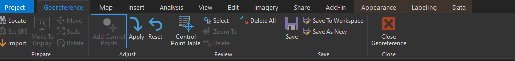

I want to georeference a DWG file to make it a feature class.
However, whenever I start adding controls points, the option becomes unavailable after I add 2 controls points. But, 3 is the minimum necessary to have acceptable accuracy.
My reference is just the regular esri basemaps.
This is what happens as soon I add a control point.

I'm experiencing the same problem. After adding 2 control points, I click a vertex in the dwg to add a 3rd. At this point the Add Control Points button becomes greyed-out, and the only thing I can do is to Apply the 2 control points. After this the Control Point Table is cleared. Very strange behaviour, as imo it should be possible to transform the dwg by adding multiple control points to correctly georeference it.
