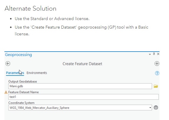

For those experiencing this issue, are you running Pro with a Basic license?
There is a bug that leads to options being grayed out in the right-click context menu: BUG-000132678: Creating a feature dataset is disabled in the contex..
We apologize for this, but I thought it would be important to note that you should still be able to move forward by running the geoprocessing tool until the fix is released.

KoryKramer
Esri Community Moderator
Thank you.
AbraKaiser
Thanks for this workaround, I didn't know where was a tool for that.
