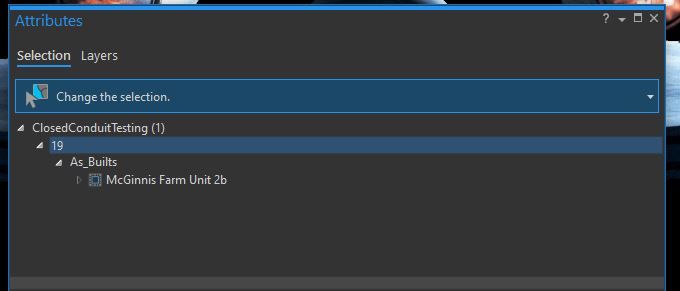

No, it is something that is honored despite not being able to directly see the relationship that you created in the map. If you already have the features that participate in the relationship in the map currently, then you should be able to test it by selecting the feature and viewing the attributes. It should look something like this:
The relationship is stored in the database; it is something that cannot be added to the map directly.

Okay, I see now that the relationship does follow when published to a web layer on AGOL.
Thank you.
