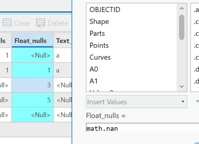

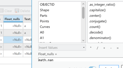

003571: Certain rows set to NULL due to error while evaluating Python expression: Cannot be evaluate...
And yes it does set things to null (my field in the image had numeric data in it as well as <null>
Now, numpy and math have "nan" (not a number, aka None-ish)
with no warning and it sets to <null>
... sort of retired...
