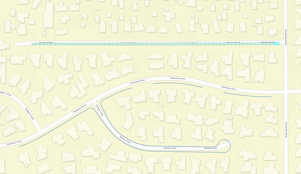

Apologies for the noob post, but can anyone recommend a way to create a series of identical polygons along a curved path, like a road edge?
I've used the divide tool on a polygon in George Street to get what I want, but this tool won't work for the curved line along Rolleston Drive/Henley Close (shown below).
Would I be heading in the right direction by using the Traverse tool?
Thanks in advance!

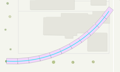

centerline the road?
Polygon To Centerline (Topographic Production)—ArcGIS Pro | Documentation
Then Buffer the centerline then Divide the resultant
Subdivide Polygon (Data Management)—ArcGIS Pro | Documentation
