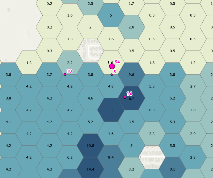

I have a polygon tessellation representing 5 acres, and is populated with an estimated value of children between the ages of 0-10. I have a point feature class that represents child care locations and it contains a capacity number. I want to somehow represent how many of the nearest polygons would be needed to fill the capacity of the point value. So if I have a point with a capacity of 50, I would want to know how many of the closest polygons that point would cover.

Here's an attempt. Hexagons have "populations" between 1 and 5 (light to dark). Black points are the child care centers and their capacities are shown in the adjacent black labels. Regions made up of hexagons that have aggregated enough "population" to reach each capacity for each center are shown in the colors, with the "actual" population gathered labeled with the callouts.
The caveats:
  1. Regions can overlap if centers are too close (see red/blue). Lots of fixes for this, depending on what you're after.
  2. Childcare centers can be "over" capacity. See green region, where the max capacity is 80, and 81 have been "gathered" from adjacent hexagons. Also lots of fixes, depending on needs.
Code below, in simple terms: for each center, add the closest hexagon to a region, followed by the next closest, etc., until enough hexagons have been added so the summed population reaches the capacity of the child care center. This runs extremely quickly with ~1,300 hexagons, but is definitely not the most optimized.
You'll have to edit this code if you want to use it with your own feature classes. Happy to provide more details if you need them.
