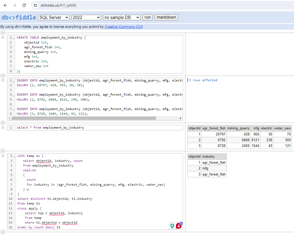

I normally work with Oracle, not SQL Server, but I was able to quickly mock up the SQL Server solution from this answer: Getting the column name that holds the maximum value of a row
I did it in db<>fiddle.
with temp as (
   select objectid, industry, count
   from employment_by_industry
   unpivot
     count
     for industry in (agr_forest_fish, mining_quarry, mfg, electric, water_sew)
   ) u
select distinct t1.objectid, t2.industry
from temp t1
cross apply (
    select top 1 objectid, industry
    from temp
    where t1.objectid = objectid
order by count desc) t2
I don't know if that's the simplest solution or not.

Bud
Legendary Contributor
with temp as (
   unpivot
     count
   ) u
from temp t1
cross apply (
    from temp
@AlfredBaldenweck@JoshuaBixby, and @AJR might find this interesting.
HanliePetoors
@Bud thanks this is a very elegant piece of SQL and a great solution.
Regards
Hanlie
